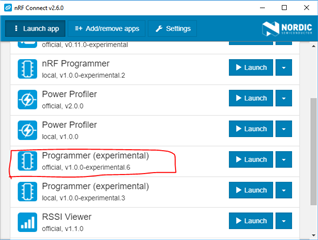

  • Again I got lost on the different link.
    1) nRF Connect has the experimental 5 as default. Found a new version available experimental 6. -> OK.
    But now what hex file should I load? "the ble_app_uart_pca10056_s140.hex" is for pca10056 board.
    My dongle is pca10059. I loaded the pca10056 but the dongle is not functioning.
    2) Do not understand what is the DFU Trigger, if it is useful for my problem.
    3) For the nRF5x-Command-Line_Tool-Win32, I will probably have the same problem for the hex file to upload.
    I appreciate the time you spend to help me... :-)
    BTW I just received my DK now and will probably drop the dongle.
    Jean-Marc
  • Good morning, Jean-Marc!
    1) 5 worked fine as well, but nRF Connect got an update recently, so I thought I should refer to the latest version. It is just important that you use the experimental 5/6, as this is the only version that can program the softdevice and the application.
    Can you specify what you mean with "dongle is not functioning"? Are you able to program it? (Do you get any errors in nRF Programmer?)
    It may be that the application is running, but you will not get the UART information, because the dongle is not connected with the pins used for UART.
    This will be easier to understand now that you can compare it with the DK.
    If you program the same hex file (It is the one you found in the SDK\examples\ble_peripheral\ble_app_uart\hex folder, right?), and you open Putty or Termite (UART terminals) you should see some text like "UART example started". Remember that when you compile the project yourself, you also need to program the softdevice, located in SDK\components\softdevice\s140\hex. If you use Segger Embedded Studio, you don't need to think about this, as it programs the softdevice for you.
    For your dongle, please try the example file: SDK\examples\peripheral\usbd_ble_uart\pca10056\
    You need to compile this project, as it doesn't have precompiled hex-files.
    The reason that it is different for the dongle is that the USB part of the dongle is the part that you plug into your computer, and it is not the same as the USB on the short side of the DK, it is the same as the USB on the long side. Basically, you can't use the USB pins on the dongle to transfer UART data. This is probably why you think that the .hex file doesn't work.
  • 1) No the experimental 5 does NOT work on my dongle. It cannot find the USB device. That is why I search and found the experimental 6. Which is indicated on a small "i" to click. This is ridiculous... Who wants to click on a such small indicator... :-(
    2) Yes I Add .hex file usbd_ble_uart\pca10056, then do "write". Then I loose the contact of the dongle. It says "Connect to a DevKit to see the contents of its non-volatile memory here". ???
    3) Since I loose the contact of the dongle I cannot open Putty or any terminal to it I do not have any com port.
    Anyway doing OK with the nRF DK.
    But do not see much interest for the dongle. Also Connect is not as nice as was Master Control Panel which does not work anymore. Neither on my nRF51 dongle nor the new dongle.
    Thank you for your help...

  • Thank you for the follow up.
    1) When you install Connect the experimental 5 is the one installed, and when I open the Programmer app it does not found my dongle. Looking at the Connect screen on the "Programmer (experimental) I could see a very small icon blue with (i). When clicking on (i) I could see that the (experimental 6) is available. I download it and it worked. So Programmer seems to work, find my dongle.
    2) I can flash my ble_app_uart_pca10056.hex into the dongle with Programmer but then loose connection with the dongle. So my question is: What do I need this for if I loose the connection with the dongle? For me this situation is useless.
    I appreciate your help. Thank you.
