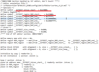

I am using nrf52832, SDK v14.2, Softdevice s132_nrf52_5.0.0.
I had program the softdeive in flash, and I program the DTM firmware as application(start address set as 0x23000), however DTM cannot be measure by Anritsu MT8852b.
But if I only program DTM (start address set as 0x0), then DTM can measure by Anritsu MT8852b.
What should I do if I had softdevice in flash, and I want to program DTM firmware as application too ?

  • Dear Jorgen,
     I used IAR to build DTM firmware, and I only change ROM start address to 0x23000 in "direct_test_mode_iar_nRF5x.icf",
     and then merge use mergehex.exe to merge the "Softdevice s132_nrf52_5.0.0" and DTM firmware in only one firmware.
     Below is my DTM address :
    I only change the ROM Start Address in DTM firmware, and I didn't change any code .
    Whether RAM Start address or anything should I change?
