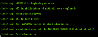

Why the value of the reset reason register is not correct when nRF52832 based s132_nrf52_6.1.0?
Dear,
         When I use the s132_nrf52_6.1.0 for nRF52832,  I find that the value of the  reset reason register is not correct by using the function "sd_power_reset_reason_get()". And the value is always 0x01 whenever whether the nRF52832 is waken up from power off mode by a GPIO pin trigger.
      But when I use the s132_nrf52_2.0.1 for nRF52832,  I find that the value is correct.
      I do not know which reason has resulted in this problem.
     I will look forward your useful guidance.
   Thanks very much for your help.
