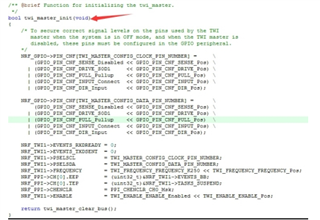

My IIC configuration is as follows

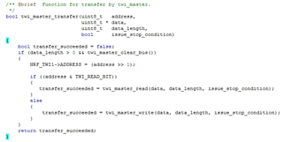

I call this function to read and write IIC
Now encountered such a problem: if I only configuration, namely just call twi_master_init initialized to the IIC, but no IIC bus communication (i.e., don't call twi_master_transfer), the standby power consumption in the normal range (around dozens of UA), but after the initialization, IIC communication, using twi_master_transfer standby at this time (not to carry on the IIC communication) power consumption increases to more than 600 UA.

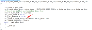

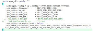

My SPI configuration
I call this function to read and write to the device
Now encountered such a problem: if I only configuration, namely just call spim_init initialized to the SPI bus, but don't use SPI bus communication (i.e., don't call Spim_dma_read_write), the standby power consumption in the normal range (around dozens of UA), but after the initialization, SPI communication, using Spim_dma_read_write standby at this time (not the SPI communication) power consumption increases to around 1000 UA.

1. As shown in the IIC in the screenshot, what should I do with IIC's uninit operation?(after I used it, I configured the IIC pin as the GPIO default setting and called the nrf_gpio_cfg_default function, but no effect, the power consumption was still high).
2. After I used the spi, I called the nrfx_spim_uninit function, but the power consumption did not decrease.If you do not reinitialize the SPI at this point, it cannot be used.
