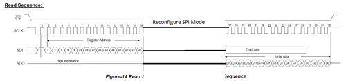

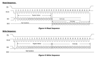

how to drive spi CS line low for 32 bits.
Can you please direct me to the document that explains about generating more than 8 bits of clock in SPI and keeping CS line low for that entire period.
Also, if i have to send two 16bit data, would i have to send them in lots of 8bit ? or i can send them as 16bits using nrf_drv_spi_transfer API?

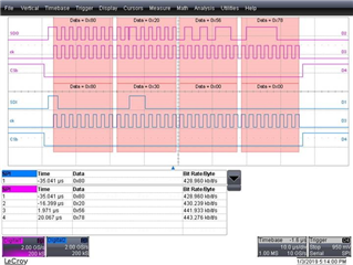

I am modifying the SPI example found under SDK15/example/peripheral/spi.
And i have to achieve the sequence attached in the image.
Thank you

  • Hi, I talked to the manufacturer. He asked me to check the SPI timings by doing a simple read operation on register 0x30 . I should be reading 0x6886 but i am reading 0Xffff instead. May be because of the pull up resistors on SPI pins ???
    It is a very small code base . I will be glad if you could verify for me if the code is right

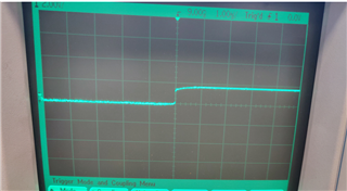

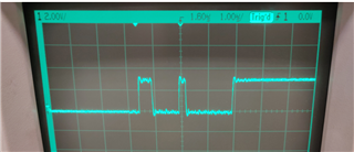

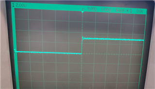

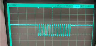

    I am also attaching the O'scope diagrams of CLK and MOSI line .
     5277.Atmel-46004-SE-M90E36A-Datasheet.pdf
    Are you able to scope all SPI lines, so that we're able to see that the mode is successfully changed when reading the response from the device?
    Håkon

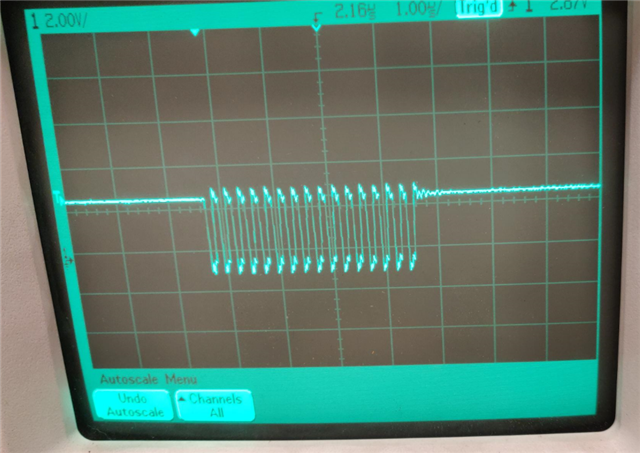

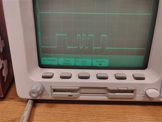

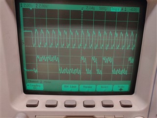

  • This looks like only one part of the SPI communication, the first 16 bits, where you lack the mode switch over to the last 16 bit transfer. Do you have access to a logic analyzer/oscilloscope with 4 channels, so that you can sample all lines simultaneously?
  • Hi Hakan,

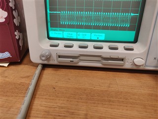

    Unfortunately I have access to only one channel oscilloscope for now. Have ordered one with 4 channels.
    I have reduced the code base just to see the mode switch. I can only see a consistent 16bit clock with no delay as described in this attached picture.
    The code does not work as expected .

    You are not waiting for the SPI transfer to be finished (missing while(!spi_xfer_done)).
    Since you initialize the SPI driver with a spi_handler set, this will set the driver into non-blocking mode. If you want blocking mode, set the handler to NULL when initializing the driver.
    Håkon

    I am still struggling to produce correct SPI timings . Below is the actual SPI timing sent to me by an Application Engineer from MICROCHIP. I need to replicate the same using nrf52840 chip :
    I am getting these SPI timings using the same operation as in above image through nrf52840 chip .
    Can you identify what is going wrong with my attached firmware ????
    Any kind of help or suggestion will be appreciated . We are really running late now on our project .
