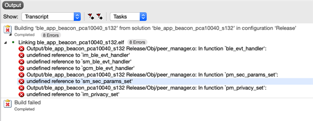

    I tried the ble_app_beacon example from Embedded Studio 4.10.
    I thought simply enabling the PEER_MANAGER_ENABLED macro and adding the source file peer_manager.c would end this.
    Are there extra steps left for solving this error?
  • Do you intend to support pairing/bonding in your app? In that case I think ble_app_hrs/ble_app_template would be a better starting point. The beacon example is missing several source files typically used to manage BLE connections. sdk_config.h will only enable compilation of source files included in the project.
    Then, what should I add to make the beacon example (both iBeacon and Eddystone) to change its address every 5 minutes?
  • Thanks for the clarification. The peer manager is meant for bond management, so will not be needed in a beacon application.  I would suggest to use the SD API to enable privacy instead.
    API to enable privacy: sd_ble_gap_privacy_set()
