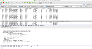

  • UPDATE:
    I have sniff the network and, It throws a 0x13 ERROR
    It's interesting that you seem to get the same behavior with both Noble and Bluepy. Have you tried using the built-in BT device on the Raspberry Pi as well?
    The sniffer trace is shows that the central terminates the link, so I think the you need to debug this on the Raspberry side. The central should generally not disconnect because of connection parameters requested by the peripheral.

    I don't think your code changes is causing the problem here. It could be a problem with Bluez considering it fails with both Noble and Bluepy.  Have you tried to disable long MTU+DLE? I think it can be worth a try.
    Disable long MTU and DLE in sdk_config.h:
