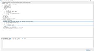

    Edit: Just setup the sniffer - someone needs to look at the instructions for that, they are awful! Oh, and make it work with the 'nRF82840-Dongle' too (currently there is no way to get the firmware onto it).
    Anyway, I am getting direct advertisment packets, despite  nRFConnect (running on Android) complete refusal to re-connect to the peripheral using them.
    10070 225.442 f6:d7:12:6c:99:d8 LE 1M LE LL 12 500 0 ADV_DIRECT_IND
    10071 225.449 f6:d7:12:6c:99:d8 LE 1M LE LL 12 500 0 ADV_DIRECT_IND
    Adv data thus, and the MAC of the central is in there 9C:E0:63:FC:FC:D6
    0000 06 1f 00 02 86 35 06 0a 01 25 31 00 00 4f d7 02
    0010 00 d6 be 89 8e 21 0c d8 99 6c 12 d7 f6 d6 fc fc
    0020 63 e0 9c b6 ca e5
    Wireshark screenshot below. Given that this does not even re-connect with nRFConnect (android), it looks like I shall have to give up! No hope of me getting it to work with my own app.

    It may be that the specific android phone you have don't support directed advertising. To ensure that directed advertising is supported the peripheral device should do a discovery of the central address resolution characteristic (CAR) of the phone, and if it is bonded and supported by the phone, then the peripheral can do directed advertisement. The implementation to check for CAR was included for the HID examples in SDKv15.2, you may try: \nRF5_SDK_15.2.0_9412b96\examples\ble_peripheral\ble_app_hids_keyboard for comparison.
    Kenneth
  • Oh.... As directed advertising appears to be a standard part of BLE 4.2 and all devices I am targeting are BLE 4.2 or better I assumed this would just work.
    Guess I will have to forget directed advertising as a solution and return to fast advertising+whitelisting.
