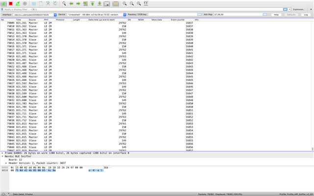

I'm getting started using the nRF Sniffer with PCA10040 and Wireshark on MacOS. I followed the instructions in the User Guide and was finally able to set it up by looking at some other posts in the devzone.
I am getting sniffed packets in Wireshark, however, I don't know if they're not properly parsed, or if I moved some configuration that's filtering out those packages.
That is what I'm getting now. In the beginning, I was getting different protocols, I could see LL LE and ATT packets. At some point, I discovered an option to disable LL packets and I selected it. I was still getting all ATT packets and it was working fine. Then I stopped the session and started a new one and I couldn't get those packets anymore.
I can't find a way to reenable those packets. What did I mess up? Help!
