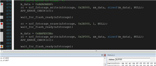

I am trying to write some data to flash.
Could anyone explain to me why values in memory are different than 0xBAFEDCBA?

I would say that you stopped app before executing flash write. You should stop after wait_for_flash_ready() not before it. In your case write is probably queued but not yet processed.

Thank You Michal,
You are probably right, it may be so easy.
I will test it for some time now.
