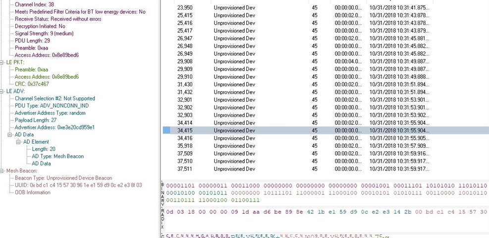

Hi Team,
Being trying to run the Thingy 52 mesh demo following :https://github.com/NordicPlayground/Nordic-Thingy52-mesh-demo
I am using pre-built .hex file Thingy_node_s132.hex. While green LED is blinking on Thingy 52, yy BPA600 could capture the mesh beacons from Thingy 52 that is advertising unprovisioned device beacon:
But nRF Mesh app on my iPhone 7 could not find it. Anything that I am missing here?
And when I use another Thingy 52 which is programed the pre-built Thingy_bridge_s132.hex file, then the bridge could provision the node automatically, so what's the difference from the phone app?
