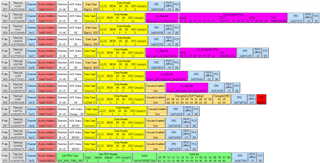

I'm using the nRF52832 with the SoftDevice S132 V6.0.0 in the central role and would like to encrypt a link with a stored LTK.
The encryption with the function sd_ble_gap_encrypt() with the correct LTK works fine. But when I start the encryption procedure with a peripheral that has an incorrect LTK, I would have expected that the BLE_GAP_EVT_DISCONNECTED event with the reason 0x3D (MIC failure) occurs, as it is described in this MSC.
Instead, I get the BLE_GAP_EVT_DISCONNECTED event with the reason 0x08 (Connection Timeout) after the supervision timeout expired. Am I doing something wrong or is this a bug in the SoftDevice?
