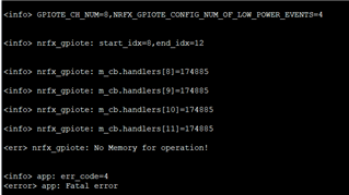

        When I added more than 4 buttons by modifying the example "ble_app_uart" of nRF5_SDK_15.2.0_9412b96, nRF52832 can not run normally.

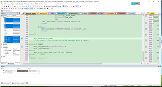

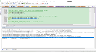

            Another strangely problem that is from the debug output information, I find that the value of NRFX_GPIOTE_CONFIG_NUM_OF_LOW_POWER_EVENTS is 4. But in the example code I find the value of NRFX_GPIOTE_CONFIG_NUM_OF_LOW_POWER_EVENTS is 1 by macro defined in the file "sdk_config.h" and I searched all the project files and cannot find any place the the value of NRFX_GPIOTE_CONFIG_NUM_OF_LOW_POWER_EVENTS is defined as 4. This problem also confused me.

    You can adjust the define NRFX_GPIOTE_CONFIG_NUM_OF_LOW_POWER_EVENTS to the number of GPIOTE low-power events you need in your application. If you are adding e.g. 5 buttons, then you should set GPIOTE_CONFIG_NUM_OF_LOW_POWER_EVENTS and NRFX_GPIOTE_CONFIG_NUM_OF_LOW_POWER_EVENTS to 5.

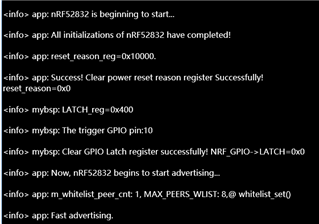

           I also do an another test that I configure the Button1 as a wakeup button by bsp_wakeup_button_enable( ) in the function bsp_btn_ble_sleep_mode_prepare( ). But when I push the sleep button I find the nRF52832 exit from sleep mode immediately just like at the same time I pushed the sleep button. The following is my debug information.
         The GPIO pin 10 is the button 1. Actually the nRF52832 can not go into sleep mode at all when I configure the Button1 or Button 2 as wakeup button. And when I do not use Button1 or Button 2 as wakeup button, the nRF52832 can go into sleep mode successfully.

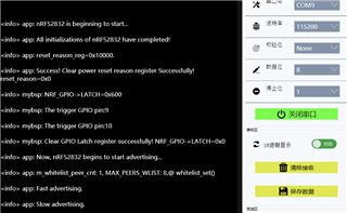

            Firstly, thanks very much for your kind help. You are right and when I define the CONFIG_NFCT_PINS_AS_GPIOS in my project, the GPIO pin 9 and pin 10 can work normally.
           But now there is new problem turns up. In my project, button1 uses GPIO pin 10 and button2 uses GPIO pin 9. Every time when nRF52832 in sleep mode, I push any of button1 or button 2 , the content of NRF_GPIO->LATCH always 0x600. It confused me.The following is my debug information.
    (Because I find that even if I do not configure any wakeup key ,any button can also wakeup nRF52832 after has called buttons_leds_init( ). So I do not configure the button1 and button2 as wakeup key in my project. )
         Which reasons have resulted in NRF_GPIO->LATCH always 0x600 when I pushed different buttons using GPIO pin 9 and pin 10.
