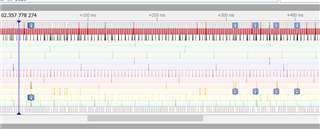

  • Hi Bjørn
    Attached is a sniffer trace between the master and one of the peripherals using Sniffer V2 and Wireshark.
    • From packet 0 to 400 is peripheral advertising
    • From packet 400 to 1050 (roughly) they are connected by not talking (only one connection)
    • From packet 1050 five more peripherals connected, but with peripheral 1 still not talking
    • From packet 1300 (roughly), the monitored peripheral and central communicate
    Pico intervals 2.pcapng
    From what I could see, the timing corresponded exactly to my previous findings, except that it looks like the peripheral sends the WRITE_RSP in the same connection interval as when it received the write command from the central and also appears tp respond with a notification in the same event (all 150us apart). So is the softdevice receiving the WRITE_RSP event and possibly also a notification from the peripheral in the same 1ms, but only giving that back to the application layer >200ms later?
    Let me know your thoughts
    Thanks

  • Hi Bjørn
    Thanks for the detailed response.
    From my side, I will change NRF_SDH_BLE_GAP_EVENT_LENGTH to 6 and see what happens to the timing. It will be great if the fix is that simple and I'll let you know what the result is.
    However, the sniffer trace indicates that the Write response is sent after 6-8 connection events, so it is either the peripheral that takes longer to send the Write Response or it is missing 6-8 connection events
    Forgive me, but I believe you are not interpreting the trace correctly. A WRITE_RESPONSE is never sent from a peripheral as the first comms on the connection event. It is always after the master sends an Data Channel PDU to start the communications. As per BLE spec Vol 6 Part B 4.5.1:
    "The start of a connection event is called an anchor point. At the anchor point, a
    master shall start to transmit a Data Channel PDU to the slave. ... The slave
    listens for the packet sent by its master at the anchor point."
    What you pointed out with no packets being sent between the master or slave for the 6-8 connection events points to the softdevice not sending the Data Channel PDU as per Spec:
    "Each connection event contains at least one packet sent by the master."
    Here is a breakdown per packet from 1302 in the trace
    (Connection EVT 1)
    1302 - Master send Write Request
    1303 - Slave ack in same connection event
    No data for 6-8 connection events
    (Connection EVT x)
    1304 - Master initiales comms after 300ms with the empty PDU
    1305 - Slave send WR_RSP in same connection event
    You can look through the entire trace, but it is always the master that initiates the communications on a new connection event. If the master does not, the peripheral does not respond. You can therefor see that it is the master that starts the comms (after skipping 6-8 connection events) only 300ms later for the peripheral to then send the WR_RSP.

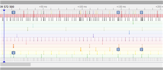

  • Yes, I think that you are absolutly correct. I just assumed that there were packets missing, i.e. that we didn't see the empty packets transmitted from the central in the trace.
    So what I think is going on is that SoftDevice scheduler on the Central is allocating the maximum event length for each connection, i.e. connection event length == connection interval, since the NRF_SDH_BLE_GAP_EVENT_LENGTH is set to 320(400ms). If we take a look at Multilink scheduling with eight connections as a Central and minimum intervall, then we see that the minimum connection interval for C0( and other 7 connections) will be 8*connection event length, which in your case will be 8*30ms = 240ms
    So setting the NRF_SDH_BLE_GAP_EVENT_LENGTH to  5, i.e. a connection event length of 6.25ms, the minimum connection interval is 5*1.25ms*8=50ms, should resolve the issue.
    Best regards
    Bjørn
  • Hi
    Great, thanks! Changing NRF_SDH_BLE_GAP_EVENT_LENGTH  to 5 does force tevent=6.25ms and the events are delivered in close succession.
    Thanks! This marathon session left me with traces coming out of my ears, but I am glad it is resolved Slight smile
