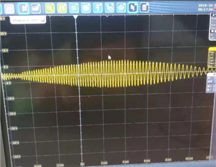

PWM modulation frequency or modulation amplitude
Hello, above is the PWM modulation waveform (positive Xuan Bo).
How does 1.nrf52832 regulate the frequency of circulation?
Take this nRF5_SDK_12.2.0_f012efa\examples\peripheral\pwm_driver example Demo1 as an example.
I want to give variable frequency.

M_demo1_top is the value of frequency control.
M_demo1_top + = 100;
If (m_demo1_top>=10000)
M_demo1_top=0;
M_demo1_top is added from zero to 10000, but no PWM has no output.
What should I do to change the PWM frequency output, from zero to high, from high to zero, modulation frequency conversion output pwm?
Looking forward to your reply, thank you.

  • Hello, thank you for your reply. It's known that you want to change. top_value = m_demo1_top. This value needs to be restarted to the initial pwm. I don't know if it's right. How to restart the initial pwm? Is it okay to start the PWM in the interruption?
  • The driver does not support it, but you could try to set the COUNTERTOP register directly in the handler. The duty cycle will also change if you only increase the top_value, so if you want the duty cycle to be the same, you will need to update the seq_value also. You will also need to add some RC filter, or similar to the pin output to get the desired output shown in the image you uploaded.
