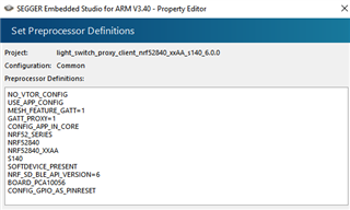

  • Update 2: Below is the preprocessor definition for the light switch proxy client example. If you compare that with the experimental dimming client preprocessor definition, you notice that MESH_FEATURE_GATT=1 & GATT_PROXY=1 are missing (which you correctly pointed out).
    As you have correctly pointed out, MESH_FEATURE_GATT & GATT_PROXY are not defined in the dimming example.
    Once these preprocessor definitions are defined, it can be helpful to close the Segger project & open it up again. That way, the sections that were uncommented under #if MESH_FEATURE_GATT should not be grayed out anymore.
