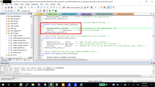

Example nRF5_SDK_for_Thread_and_Zigbee_2.0.0\examples\thread\mqttsn_client_subscriber only receives packets having length of payload is 1-byte (value 0 or 1) , I need to custom it for my application. However, this SDK don't provide length of payload as below.

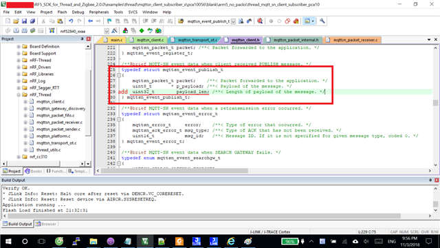

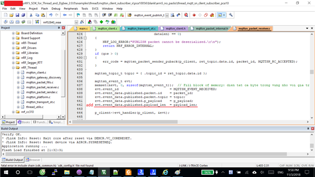

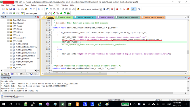

After dealing with this problems in 3 hours, I have been able to resolve it as below.
finally, write a command to test it.

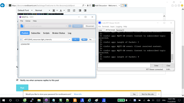

result:
