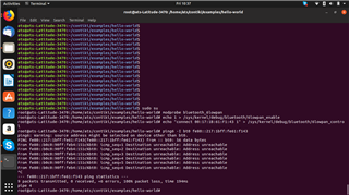

Currently i am working on IPV6 over BLE with contiki oS.
For that i am following link ...
https://devzone.nordicsemi.com/b/blog/posts/setting-up-ipv6-over-ble-using-nrf52-series-and-com
I have successfully established the connection with nRF52 DK.
After that If i ping to the nrf52 dk, i am getting following response.
ping6: Warning: source address might be selected on device other than bt0.
PING fe80::217:1Bff:fe61:F143(fe80::217:1bff:fe61:f143) from :: bt0: 56 data bytes
From fe80::b0c0:90ff:feb4:151c%bt0: icmp_seq=1 Destination unreachable: Address unreachable
From fe80::b0c0:90ff:feb4:151c%bt0: icmp_seq=2 Destination unreachable: Address unreachable
From fe80::b0c0:90ff:feb4:151c%bt0: icmp_seq=3 Destination unreachable: Address unreachable
But if i ping to local address, i am getting proper response.
PING fe80::b0c0:90ff:feb4:151c%bt0(fe80::b0c0:90ff:feb4:151c%bt0) 56 data bytes
64 bytes from fe80::b0c0:90ff:feb4:151c%bt0: icmp_seq=1 ttl=64 time=0.132 ms
64 bytes from fe80::b0c0:90ff:feb4:151c%bt0: icmp_seq=2 ttl=64 time=0.098 ms
64 bytes from fe80::b0c0:90ff:feb4:151c%bt0: icmp_seq=3 ttl=64 time=0.096 ms
64 bytes from fe80::b0c0:90ff:feb4:151c%bt0: icmp_seq=4 ttl=64 time=0.108 ms
So, please help me how to resolve this issue.
