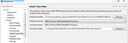

I´m using nrf52832 with sdk 14.2.0 and softdevice s332.
I have opened and closed the eclipse. Now when I open it, it compiled and gives me this error that I did not have before:
"Cannot run program "make": The system can not find the specified file."
  • The eclipse configuration is as follows:
System variables:
Path = D:\Proyectos\Nordic_plugins\GNU MCU Eclipse\Build Tools\2.11-20180428-1604\bin;C:\Program Files (x86)\GNU Tools ARM Embedded\7 2017-q4-major\bin

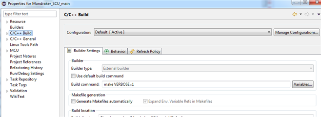

  • The configuration of the project is as follows:
Can someone tell me what may be happening?
Thanks and regards,
Francisco.
