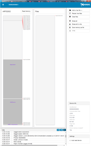

Hi awneil,
Thanks for your answer. Am I correct when I state the following:
My Segger Embedded Studio project says my code is about 184.8K code and 35.8K data (see picture below). The nRF52832's specifications say it has 512kb flash memory. So I would have 291.4kb to store data?
Jan
You've got 186kB of flash to spare. I do not know how much RAM the Thingy uses, but you should have enough left to do whatever you want to do.
