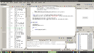

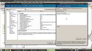

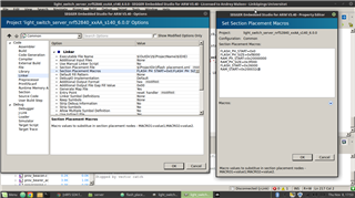

Im getting an error while running the debug ("Stopped by vector catch") see pics. I have read about this problem and the issue can be that the option "Memory Segments" is not properly set and also the option "Section Placement Macros". Thoose options are set by default and I can not find any information what it should be set to.

Some information about the setup:
OS: Linux Mint
IDE: SEGGER Embedded Studio for ARM V3.40
Example from SDK mesh: light_switch_server_nrf52840_xxAA_s140_6.0.0
Thanks!
