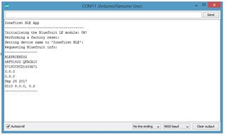

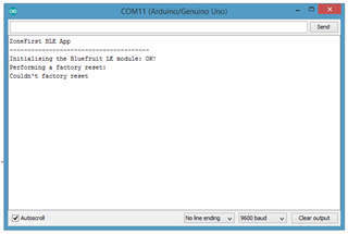

For the most part my BLE application is working well. However, there is inconsistency when it comes to initializing the BLE module when powered (either by USB to PC or outlet). Based on the monitor, it seems to not reset at times which prevents it from initializing. I am able to see the 'Adafruit BlueFruit LE' advertised on my phone and connect to it but any functionality of my application doesn't work. I know it initializes correctly when I see the device advertised as my own custom name 'ZoneFirst BLE'. This behavior of initializing/not initializing happens if I'm connecting the device via USB to my PC with the serial running or powering off an outlet. In either case I have to power it off and back on for it to correctly function. This is concerning me if we plan to move to production with this module MDBT40. Thank you!
  • BLE UART Friend with 0.8.0 Software from Adafruit
  • nrf51822 module MDBT40 by Raytac
  • Arduino Uno
  • Arduino 1.8.5 IDE
Wiring photos:
Debugger serial for sucess/fail:
