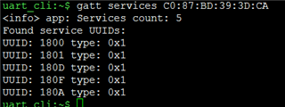

    After the service discovery, it will print the services as this:

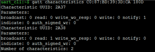

    You can then discover service characteristics like this:

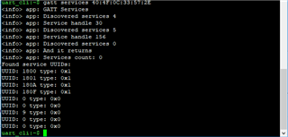

  • The reason I ask, is that I am working on a project, where I try to get all services on a peripheral, but I have encountered a problem. I have made another post on DevZone, https://devzone.nordicsemi.com/f/nordic-q-a/40124/service-discovery---att-read-transaction-0-invalid-handle, but I am still waiting on a reply, so I have tried to follow up myself.
    The problem I have, is that i can't make a Service Discovery on the peripheral. I have explained why, on the other post.
    For trying to solve it myself, I wanted to see what happened between each service discovery.
    On the picture, I make it write out when it starts on the GATT Services. Then I make it print out, p_prim_serv->count, and I print out, p_prim_serv->services[count - 1].handle_range.end_handle. And this is where my scenario is, it discovers service 0, I think it discovers an unidentified UUID, and can't handle it. I have tried to remove the return statement, and see what it prints out, and this it what it finds:
    It finds the first identified UUID, but then it comes to an unidentified UUID, and it breaks. And this is where it leads me back to my question in this post, I want to see what happens in between the UUID discovery, what makes it break? It can find UUID, 1800, 1801, 180A and 180F, but then it breaks.
    I don't really now how to proceed from here on, that is why i asked you for help. Hope you can see what I mean by all this.
    Best regards Andreas
