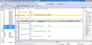

I am using NRF52832, twi_sensor_pca10040 example with SHT3X sensor.
I changed slave address to 0X44 and SCL, SDA pin to 27 and 26. TWI TX transfer work fine, in response I am geeting 6 byte of data from SHT3X sensor ( TWI slave address 0x44 ).
In twi_sensor_pca10040 example, from twi_handler() hadler, read_data() function is called. For received data manupulation, I changed code logic in read_data() function, called from twi_handler(). Every time read_data() function called I get HardFault_Handler fault and board hang.
For testing, I commented read_data() function; then after TWI RX data buffer updates fine with every TWI TX request. I checked it by placeing read buffer in keil debug mode watch window.
Why function call from twi_handler() is giving me HardFault_Handler fault? I am not getting how to debug it?
