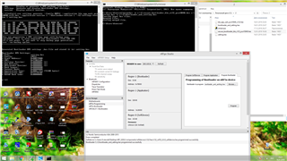

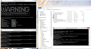

bootloader uploaded

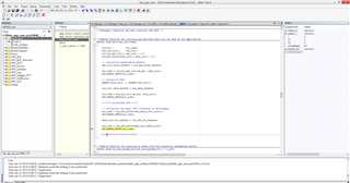

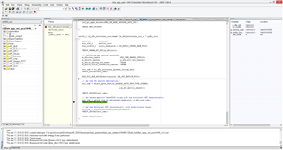

Which error code is returned by ble_dfu_buttonless_init()? Can you step into ble_dfu_buttonless_init and see which internal function that returns the error code?
Returns the error code function err_code = sd_ble_uuid_vs_add(&nordic_base_uuid, &m_dfu.uuid_type);
VERIFY_SUCCESS(err_code);

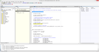

0x04 means NRF_ERROR_NOMEM, which is generate by sd_ble_uuid_vs_add when there are no more free slots for VS UUIDs,
You need to increase NRF_SDH_BLE_VS_UUID_COUNT in sdk_config.h to 1.

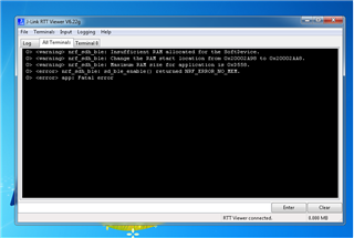

I get error in function static void ble_stack_init(void).
I changed NRF_SDH_BLE_VS_UUID_COUNT with 1 in 2, but now in function:

the the execution the execution enters in the block
NRF_LOG_WARNING("Insufficient RAM allocated for the SoftDevice.");
NRF_LOG_WARNING("Change the RAM start location from 0x%x to 0x%x.",
app_ram_start_link, *p_app_ram_start);
NRF_LOG_WARNING("Maximum RAM size for application is 0x%x.",
ram_end_address_get() - (*p_app_ram_start));

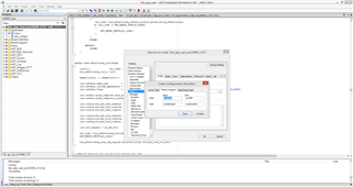

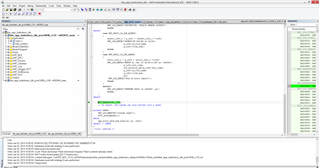

I modify RAM start and RAM STOP in IAR.
after started project.

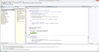

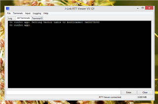

How do start work DFU? I use function ble_dfu_buttonless_bootloader_start_finalize(); but she not started DFU.

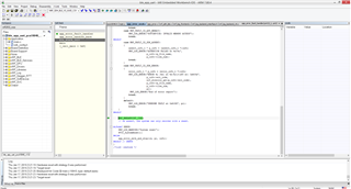

Error on line nrf_pwr_mgmt_shutdown(NRF_PWR_MGMT_SHUTDOWN_GOTO_DFU); in function
uint32_t ble_dfu_buttonless_bootloader_start_finalize(void)
uint32_t err_code;
NRF_LOG_DEBUG("In ble_dfu_buttonless_bootloader_start_finalize\r\n");
err_code = sd_power_gpregret_clr(0, 0xffffffff);
err_code = sd_power_gpregret_set(0, BOOTLOADER_DFU_START);
// Indicate that the Secure DFU bootloader will be entered
m_dfu.evt_handler(BLE_DFU_EVT_BOOTLOADER_ENTER);
// Signal that DFU mode is to be enter to the power management module
return NRF_SUCCESS;
I don't know that do. Help me.
Alex, when you report that functions return errors, then you need to provide the error codes so that we can find out what caused the error. Also do you mean a compilation error or a run-time error?

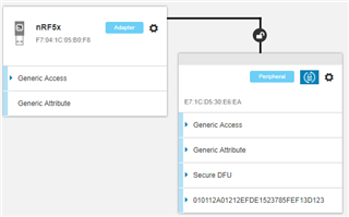

After calling the ble_dfu_buttonless_bootloader_start_finalize() function the device should jump to the bootloader and the device should start advertising as DfuTarg. You can then connect to the device using nRF Connect for Desktop or Mobile(ios/Android) and then start a DFU by pressing the DFU icon, the blue lock and then select the image you want to upload

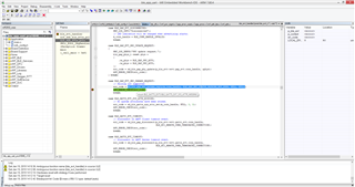

ble_dfu_buttonless_bootloader_start_finalize -> nrf_pwr_mgmt_shutdown(NRF_PWR_MGMT_SHUTDOWN_GOTO_DFU) -> nrf_pwr_mgmt_shutdown(nrf_pwr_mgmt_shutdown_t shutdown_type) -> shutdown_process(void).
static void shutdown_process(void)
if ((m_pwr_mgmt_evt == NRF_PWR_MGMT_EVT_PREPARE_RESET)
|| (m_pwr_mgmt_evt == NRF_PWR_MGMT_EVT_PREPARE_DFU))
NVIC_SystemReset();
And occurs System Reset.
