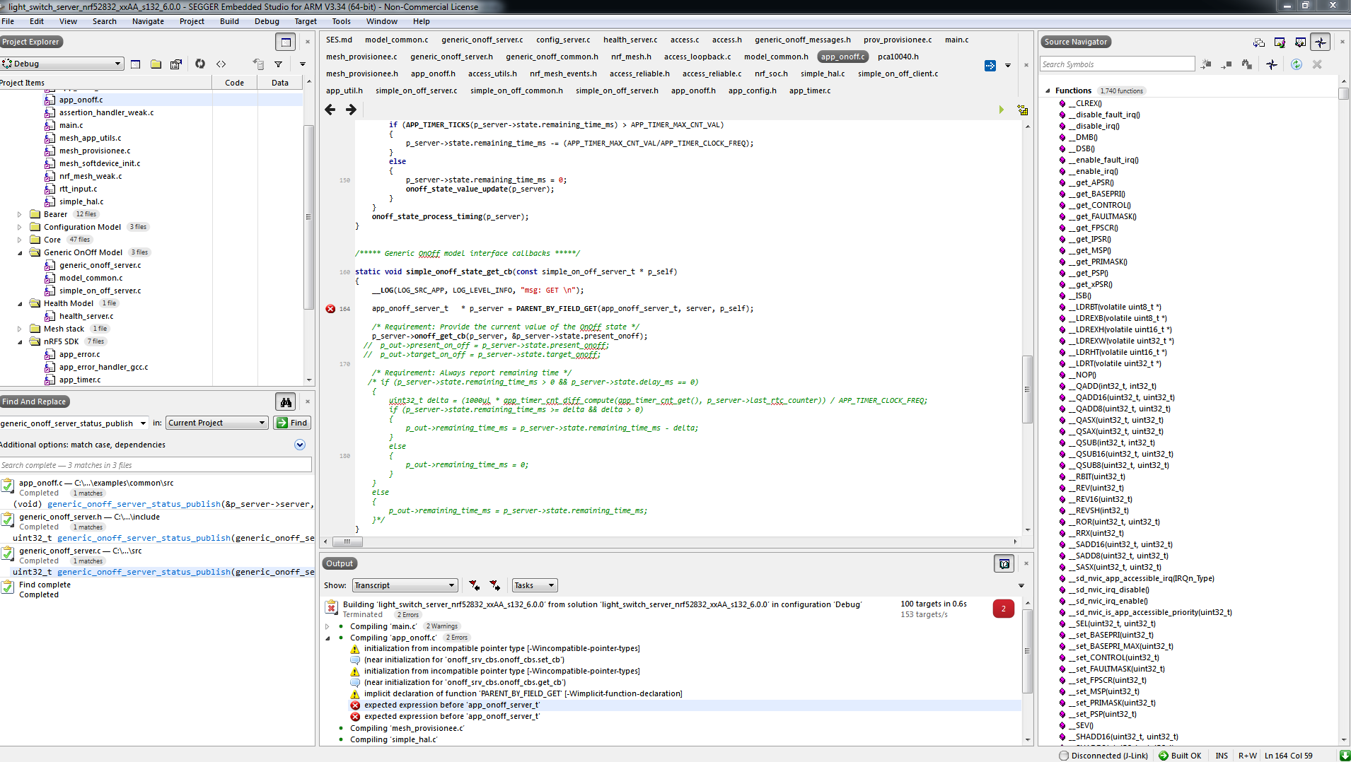

Mesh SDK V2.2.0 from generic onoff model to simple on off model ( server/client )
after implementing some changes on the client and server examples i could compile my algorithm for the client but in the server i still have some problems which i didn't find the solution
all generic onoff callbacks with simple on off callbacks  and modified the simple onoff structures like the generic onoff a little and in the final i want to make a model that sends String or an array of char in the mesh network .

uint32_t app_onoff_init(app_onoff_server_t * p_server, uint8_t element_index)
    uint32_t status = NRF_ERROR_INTERNAL;
    if (p_server == NULL)
        return NRF_ERROR_NULL;
    p_server->server.p_callbacks = &onoff_srv_cbs;
    if (p_server->onoff_set_cb == NULL || p_server->onoff_get_cb == NULL)
    status = simple_on_off_server_init(&p_server->server, element_index);
    if (status == NRF_SUCCESS)
        status = app_timer_create(p_server->p_timer_id, APP_TIMER_MODE_SINGLE_SHOT,
                                  onoff_state_timer_cb);
    return status;
