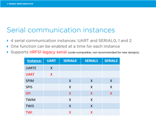

In https://devzone.nordicsemi.com/f/nordic-q-a/30206/spi-with-ble-in-nrf52832, you said it cannot use UART 0 and SPI0 or TWI0 together.
Why?
In nRF52832 Datasheet, the base address of UART 0 is 0x40002000 and the base address of SPI0/TWI0 is 0x40003000.
It is different base address of these I/F instance 0.
Please help to check.
