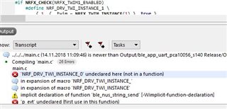

why i am getting error in twi instance 0
hi...
i had merged the two programs , twi sensor and uart in segger 15.2 version . i am using nrf52840  i am getting the error in twi instance 0 . i couldn't find what error it is ? please can one tell me
 see the pic below
  • If the examples are using the legacy driver API, i.e. nrf_drv_twi_ etc, then you need to set the following definitions
    // <e> TWI_ENABLED - nrf_drv_twi - TWI/TWIM peripheral driver - legacy layer
    #ifndef TWI_ENABLED
    #define TWI_ENABLED 0
    // <e> TWI0_ENABLED - Enable TWI0 instance
    #ifndef TWI0_ENABLED
    #define TWI0_ENABLED 0
    and set the NRFX_TWI_ENABLED and NRFX_TWI0_ENABLED to 0.
    Best regards
    Bjørn
