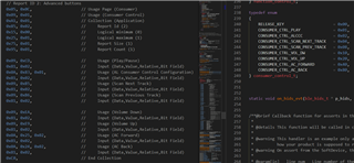

Hi
I was trying to do the page up and down key, I just built it successfully but it is no response.
Could anyone find out the reason for me.
I appreciate for your assistance.

    Which is directly derived from the descriptor:
            0xA1, 0x01,                     // Collection (Application)
            0x85, 0x02,                     //     Report Id (2)
            0x15, 0x00,                     //     Logical minimum (0)
            0x25, 0x01,                     //     Logical maximum (1)
            0x75, 0x01,                     //     Report Size (1)
            0x95, 0x01,                     //     Report Count (1)
            0x09, 0xCD,                     //     Usage (Play/Pause)
            0x81, 0x02,                     //     Input (Data,Value,Relative,Bit Field)
            0x0A, 0x83, 0x01,               //     Usage (AL Consumer Control Configuration)
            0x09, 0xB5,                     //     Usage (Scan Next Track)
            0x09, 0xB6,                     //     Usage (Scan Previous Track)
            0x09, 0xEA,                     //     Usage (Volume Down)
            0x09, 0xE9,                     //     Usage (Volume Up)
            0x0A, 0x25, 0x02,               //     Usage (AC Forward)
            0x0A, 0x24, 0x02,               //     Usage (AC Back)
            0xC0,                           // End Collection
    By changing the first command 0xCD (Play/Pause) to anything else, the enum corresponding to bit 0 (CONSUMER_CTRL_PLAY) will also change behavior.
    When specifying a ReportID, you can choose any unused number between 1 and 255 (0 is reserved).

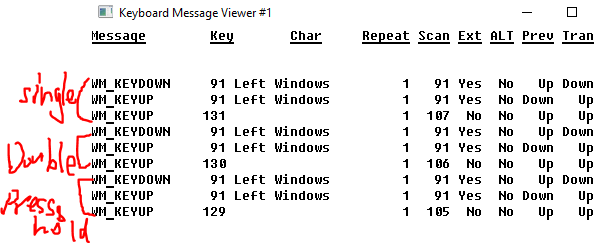

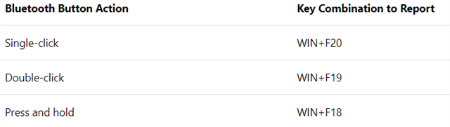

    Since a while I have tried to program the code, it still doesn't work properly.
    The main function I would like to develop is like Windows Pen.
    https://docs.microsoft.com/en-us/windows-hardware/design/component-guidelines/windows-pen-designs
    Actually, I just test with surface pen and get some information by the tool "Keyboard Message" :
    The method I tried is like below:
    static uint8_t PRESS_HOLD[8] = {0,0,0x6D,0,0,0,0,0}; //Win+F18
    static uint8_t CLEAR_CLICK[8] = {0,0,0,0,0,0,0,0}; //Null

    i. “Win” + “F18” (raw data: 08 00 6D 00 00 00 00 00)
    ii. Release “F18” (raw data: 08 00 00 00 00 00 00 00)
    iii. Release “Win” (raw data: 00 00 00 00 00 00 00 00)

  • Hi Hakon,
    Yes, I did change the USB descriptor that you mentioned before.
    The picture shows the result I tried:
    It still shows the response of Left Windows only.
    Best Regards,
    Wedy

            0x05, 0x08,       // Usage Page (Page# for LEDs)
            0x19, 0x01,       // Usage Minimum (1)
            0x29, 0x05,       // Usage Maximum (5)
            0x91, 0x02,       // Output (Data, Variable, Absolute), Led report
            0x75, 0x03,       // Report Size (3)
            0x91, 0x01,       // Output (Data, Variable, Absolute), Led report padding
            0x95, 0x06,       // Report Count (6)
            0x75, 0x08,       // Report Size (8)
            0x15, 0x00,       // Logical Minimum (0)
            //0x25, 0x65,       // Logical Maximum (101)
            //Wedy test to change
            0x25, 0x6F,
            0x05, 0x07,       // Usage Page (Key codes)
            0x19, 0x00,       // Usage Minimum (0)
            //0x29, 0x65,       // Usage Maximum (101)
            0x29, 0x6F,
            0x81, 0x00,       // Input (Data, Array) Key array(6 bytes)
            0x09, 0x05,       // Usage (Vendor Defined)
            0x26, 0xFF, 0x00, // Logical Maximum (255)
            0x75, 0x08,       // Report Size (8 bit)
            0x95, 0x02,       // Report Count (2)
            0xB1, 0x02,       // Feature (Data, Variable, Absolute)
            0xC0              // End Collection (Application)
    BTW, I just found out the reason why I can not send the F18 (105) description.
    Because of the keyboard on the laptop that FnLock.
    I just can do the WIN+F18 Function now, like below:
