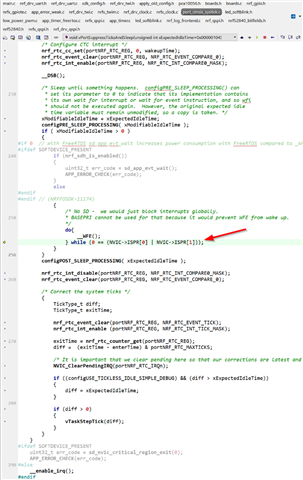

  • Thanks Susheel Nuguru, I tested the solutions on my DK board. The led blink too fast(don't looks like a softblink) and it will stop blinking intermittently before it start blink again. Was it related to the FreeRTOS timer conflict with the softblink? Do you know whereI could look into? What are the main difference between non freertos vs freertos app timer? Is the nordic softbolink mechanism based on different rtc timer from freertos?
    I tried use debug-break during the part when the led stop blinking and it stopped at the below code (port_cmsis_systick.c), tickless idle seem to interfere with the softblink feature.
