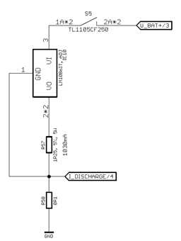

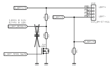

I have a problem with ADC measure and accuracy.
I want to read a voltage (U_BAT+) between 2.5 – 4.5V with an accuracy of < +/- 50mV
I have two scenarios.
  1. No load
  2. With 1A load
Schematic

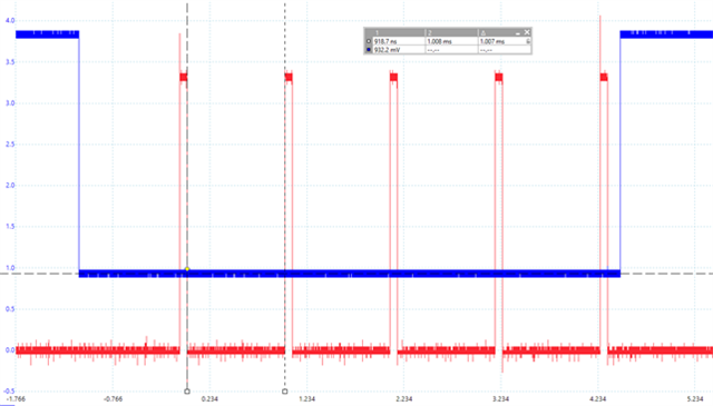

Timing
Blue        U_BAT_mess
Red         Debug LED (ADC is sampling)

The measured ADC (output on display) does not change if I connect the probe to U_BAT_mess.
Questions
  • Why is the measured and the calculated U_BAT_mess not the same ?
(The ADC impedance of 130k || to 270R should not make a difference)
  • Why does the measured ADC value not match to the measured U_BAT_mess ?
(1.2V ref / 1023 * ADC is not equal to U_BAT_mess)
  • Why is there a difference if I measure with and without load ?
