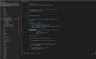

    It's in nrf_libuarte_async.c in uart_evt_handler() at line 158.  The callback handles all the event types except NRF_LIBUARTE_EVT_ERROR.  I see framing errors assert here.

    It's a bit further down in that function, the event  NRF_LIBUARTE_EVT_ERROR ends up in the default case and asserts right there in the line I've highlighted in grey.

    To be honest, I haven't played around with any examples using this library. Is there a particular reason that you use this, and not the regular uart/uarte library that is used in e.g. the ble_app_uart example? This example will handle all UART events in main.c.
    However, if you want to use this library, you can remove the APP_ERROR_CHECK_BOOL(false); and replace it with your own handling. You can even add a separate event for the NRF_LIBUARTE_EVT_ERROR event, which is probably what you are receiving, since the only four possible event types for this handler are:
    typedef enum
        NRF_LIBUARTE_EVT_RX_DATA,    ///< Data received.
        NRF_LIBUARTE_EVT_RX_BUF_REQ, ///< Requesting new buffer for receiving data.
        NRF_LIBUARTE_EVT_TX_DONE,    ///< Requested TX transfer completed.
        NRF_LIBUARTE_EVT_ERROR       ///< Error reported by the UARTE peripheral.
    } nrf_libuarte_evt_type_t;
    just add a:
    case NRF_LIBUARTE_EVT_ERROR:
        // do nothing
    before the default event.
