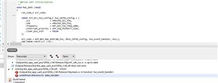

i am using nrf52832 and segger 15.2
i am merging the two programs in order to send the data through ble to phone(uart app)
i am getting the error
undefined reference to `data_handler' and twi_handler

Have you just #included the header (.h) file - but not added the source file (.c) to you project?
no i have added the c files
see the pics
this is the error
see the pics
The pictures show where you call the functions - they do not show where you define them.
Where do you define them?

Note that the Nordic SDKs require settings in the sdk_config.h file to enable (some of) the Nordic-provided definitions...

yes i have enabled the TWI_ENABLED and TWI0_USE_EASY_DMA 1.... everything i have done still i am getting errors
