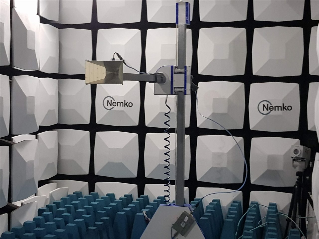

And here are some pictures from the test:
