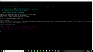

     I tried the second option that is  PyACI as a generic provisioner from a PC by following  the guide here.  and i got the below error
    In [3]: p = Provisioner(device, db)
    In [4]: 2018-11-21 14:03:40,848 - INFO - COM13: cmd KeypairSet, timeout waiting for event
    2018-11-21 14:03:42,850 - INFO - COM13: cmd AddrLocalUnicastSet, timeout waiting for event
    2018-11-21 14:03:44,853 - INFO - COM13: cmd SubnetAdd, timeout waiting for event
    2018-11-21 14:03:46,855 - INFO - COM13: cmd AppkeyAdd, timeout waiting for event
    2018-11-21 14:03:48,858 - INFO - COM13: cmd AppkeyAdd, timeout waiting for event
  • Please try again with the nRF52 board restarted. Occasionally I saw the same issue happened. But before that please verify that the PyACI can communicate properly by following this guide and this guide

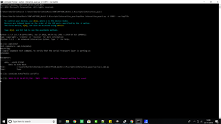

  • Hi Hung Bui I tried the above mentioned solutions also but still i'm getting the same timeout error,attached
    the screenshot for your reference.

  • nRF Mesh mobile application only support node with proxy feature. You can think of adding proxy into the beacon example. Or the otherway around adding the beacon feature (very simple) into the proxy light switch example.
    When you testing please make sure you can do  UART communication with the board (test with SDK v15 Uart example). And make sure you have flashed the mesh serial firmware to the DK.
