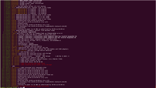

  • Hi
    The instructions means that you should find which port the DK is connected to and then pass it as a argument when you run the example. You can find out which port the DK is connected to, by running the following command after you have connected the DK: dmseg
    The attached screenshot shows the output after the command is entered. The screenshot shows that a new device is registered after the DK is plugged. The DK is registered at COM Port ttyACM0.
    Best Regards
    Jared
