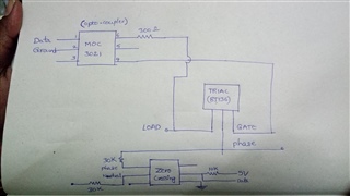

Thank you for your reply. I have executed the code given by you (below link) in Segger studio(V 3.50) I observed that the output or load (pin 31)  which is connected to ac fan is running at the set duty cycle for a while(few seconds) and it is going to high value automatically. But, i want to run it at a constant speed.
The final goal is that i have an input ac input voltage of 230v/50Hz, I want to control the AC fan with same frequency (how to set 50Hz) at different speeds (say 4 different speeds proportionally) voltage should vary according to the speed at output. Please find the circuit I am using below. How do i achieve the above goal?  Please give necessary suggestions.
Thank you.
    1) So you need a 50Hz PWM signal, with varying duty cycle?
    2) Should the PWM signal stop when pin 30 is high?
  • Hi Sigurd,
    Thank you for the suggestion. I am getting the fan speed as per my desired value but voltage and frequency is varying.
    1. Yes, we need to have 50Hz PWM signal with varying duty cycle, at the same time the voltage at the output should be constant with respect to the set (desired value) duty cycle.
    For example, if duty cycle is 50, output voltage at the load should be say 120V. similarly, if duty cycle is 75, o/p voltage should be 170V(approx.) and for the max duty cycle voltage should be 230V. But, the frequency should be 50Hz fixed as of the input AC supply frequency i.e.,50Hz only.
    To be more specific, I want to control the AC fan using Nordic (nrf52840)instead of fan voltage regulators we generally use.
     2. Yes, if the input from ZCD (pin 30) is high PWM signal should stop as per the circuit the TRIAC will drive the previous value continuously until the next zero crossing is detected.
  • So what is the issue now? You need to set the duty cycle to 3 different values, based on some user input?
  • Are you sure that's how the fan actually works?
    The speed of an AC motor is not necessarily related to the voltage - depending on the type of motor, it may be defined by the frequency.
    If you really do want to do a variable voltage AC output, then it's the amplitude that you need to vary - not the duty cycle of the waveform.  In that case, I think you need to go back to the basics of how to synthesise a waveform using PWM ...

  • Thank you for the support, I am getting the desired output according to the set duty cycle. The only issue is there is some flickering effect(slightly winding sound at low speeds). How can I run the fan smoothly?
