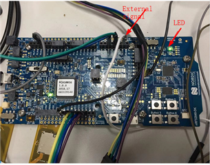

I am developing NRF52840 with the Development Kit.
I am trying to use a GPIO to o capture a external HIGH-TO-LOW signal and then trigger a LED.
I I learned the examp called pin_change_int.
But i find it's easy to capture a button signal on the board.Hard to capture the external HIGH-TO-LOW signal in my code.
Maybe u can give me some guidance.
Below is my NRF52840 Development Kit  and my code.
Thanks very much!!!

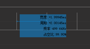

  • the Signal parameters is
    Width: +1.9945ms
    Cycle: +2.00145ms
    Frequency: 499.64Hz
    Duty cycle: 99.90%

    If you want to toggle the LED on High to Low on your input pin, I suggest that you change
    nrf_drv_gpiote_in_config_t in_config = GPIOTE_CONFIG_IN_SENSE_TOGGLE(true);
    to
    nrf_drv_gpiote_in_config_t in_config = GPIOTE_CONFIG_IN_SENSE_HITOLO(true);
    next, you are trying to use P0.01 as an input pin. If you look at the back side of your nRF52840 DK, you will see that P0.00 and P0.01 are not connected to the pinout that you are connected to. They are connected to the XTAL. It also describes what solder bridges to cut and solder in order to connect the pins P0.01 to the pinouts on the DK.
    Unless you really need to use P0.01 and P0.00, I suggest you use some other pins, because the XTAL can't be moved. It is possible to not use the XTAL, but then you will need to change the settings on every BLE example you want to use on that DK.
    If you want to connect the pinout to the chip, cut SB1 and SB2, and short SB3 and SB4.
