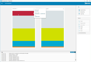

                   You should see similar memory map as presented below.
    Red Color – Bootloader
    Yellow Color – Application (with OpenThread)
    Blue Color – SoftDevice
    Orange – MBR (which is incorporated in the SoftDevice)
    Gray – Unused memory
