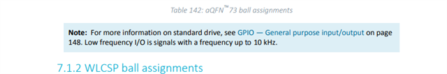

But I change this.
uart config:
define NRF_LOG_BACKEND_UART_TX_PIN  10
define Baudrate                                                 115200
define NRF_LOG_DEFERRED                         0
Terminal tool                                                      Termite
This configuration log has no output.
The above two configurations are running on pca10056 board.
