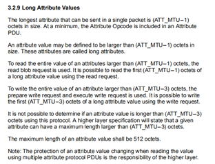

I want to implement the function of long Attribute Value reading and writing in BLEV4.0. How should nrf52832 sdk14.2 implement this function? Is there a routine for reference? How do Android and iOS phones support this feature?
Hi Jim,
we the Queued Writes module in our nRF5 SDK v14.2.0 that handles Long writes, also known as Queued writes.
I beleive that this is supported by both iOS and Android, but there could be differences depending on model and OS version etc.
