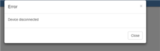

I am working on integrated peripheral and central device used for indoor positioning.  The device has two modes, at boot it is a peripheral for some duration of time then it stops advertising and becomes a central to perform the positioning activities.  When the device is central functionality works as expected.  When the device is a peripheral advertising works but I can no longer connect to the device it immediately disconnects.  I have tried both nRFConnect for Windows and my iPhone.  I am using SDK 14.2 and SD 132 v5.0.0.
The desktop nRFConnect gives me this message the following:
And I see the following in RTT <error> ble_gatt: sd_ble_gap_data_length_update() (reply) returned unexpected value 0x8

    Just to avoid race conditions I suggest you set NRF_SDH_BLE_TOTAL_LINK_COUNT to 2, this means you can have both a peripheral and central link at the same time.
    Make sure that you have control of the conn_handle's, since it may for instance be 0 or 1 (or more). This may explain why sd_ble_gap_data_length_update() return NRF_ERROR_INVALID_STATE (No link has been established, see ble_gap.h), if for instance you are trying to initiate the procedure on the wrong conn_handle (link is not established).
    I notice it says Disconnected, but what is the disconnect reason? E.g. check p_ble_evt->evt.gap_evt.params.disconnected.reason on BLE_GAP_EVT_DISCONNECTED event. Various reasons listed in ble_hci.h.

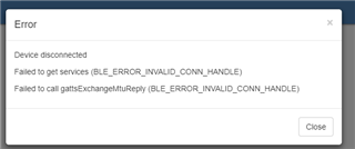

  • Thanks for taking the time to reply!  I followed your suggestions to change the NRF_SDH_BLE_TOTAL_LINK_COUNT to 2 and to add the disconnect reason but the issues still persists.  The disconnect reason is 0x16 which
    BLE_HCI_LOCAL_HOST_TERMINATED_CONNECTION
    I also am getting this nRFConnect
    Maybe this is a connection handle issue?
    Thoughts?
  • It turns out that I was calling the event handler for the central during a peripheral connection which was messing everything up.  Thanks for the help, especially the tip about the disconnection reason.
