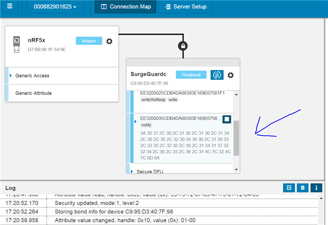

  • A few hints you might consider:
    sizeof(SomeString) for ascii data transmission is bad, use instead strlen(SomeString). The former includes all the crap on the stack after useful data when used with printf etc and might work but is not reliable. The second attempts to transmit only the ascii data you put in the string
    sprintf() is unsafe, use instead snprintf()
    "\r" may not be the same as '\r" or snprintf( ... "..\r"); be safe, use snprintf()
    Here is an example which might be useful; Central is showing additional information and it works with the Nordic Uart service you are using
