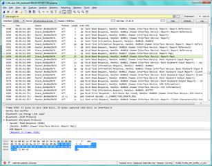

At this point I tried to understand what happened using the nRF Sniffer. It turns out that when MTU size is increased, during the pairing process with Windows 10 only a part (the first segment) of the HID Report Map is transferred to the PC. This problem does not occur with other operating systems.
When MTU size = 23 bytes and things work fine, one can see that the entire HID Report Map (consisting of 76 bytes, see array report_map_data[] in the ble_app_hids_keyboard example project) is transferred in 4 chunks (segments, at packets # 1614, 1618, 1622 and 1626) and therefore is reassembled correctly:
However, when changing the MTU size to 67 bytes, the following happens with Windows 10:
As can be seen, there is only one response packet containing the first 22 bytes of the Report Map (packet # 4359). The rest is missing (Windows 10 does not request further segments). It is obvious that such a truncated Report Map is flagged as bad by Windows 10.
Just for comparison, the following nRF Sniffer log shows the correct pairing sequence with a MacOs computer, with MTU=67 bytes (pairing succeds):
As can be seen, the entire Report Map (76 bytes) is transferred in two segments (66 bytes in packet #2432, the remaining 10 bytes in packet # 2436).
