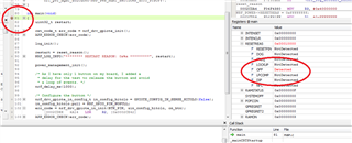

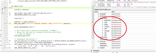

On reset, in the main, I want to read the reset reason to act differently when I come from a system off. For that, I thought to read the register RESETREAS, unfortunately, this one is set to 0.
Now, if I use the register NRF_POWER->SYSTEMOFF instead of nrf_pwr_mgmt_shutdown(), the RESETREAS is correctly set. I've seen this register must not be used when the SD is enabled, so I would prefer to use the pwr mgmt that deals with all cases.
Can you explain me why the RESETREAS does not contain any reason when using nrf_pwr_mgmt_shutdown() ?
