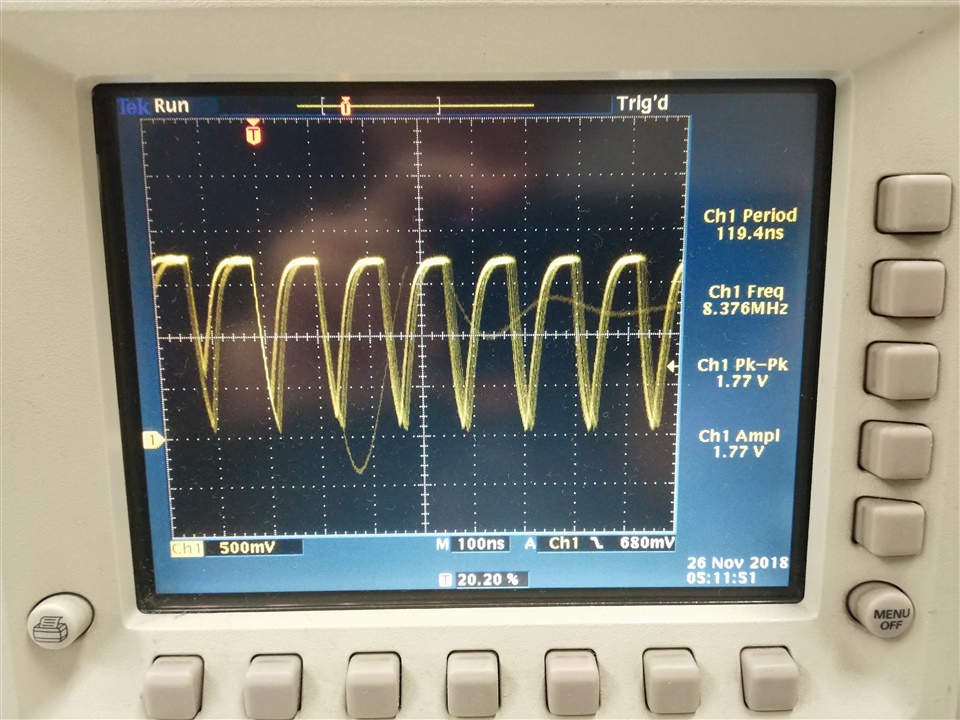

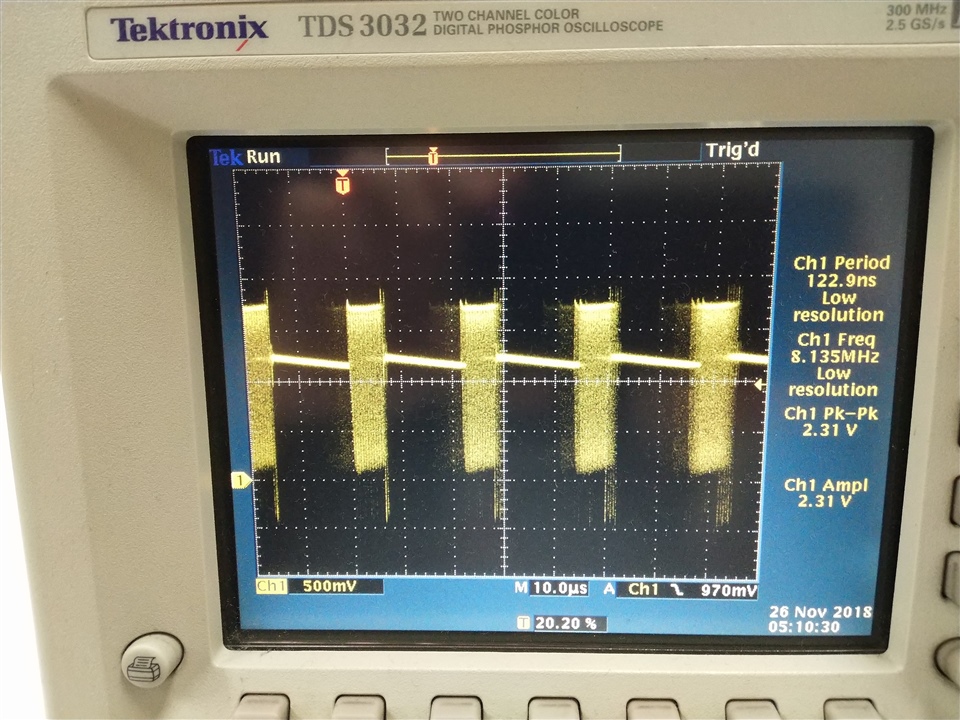

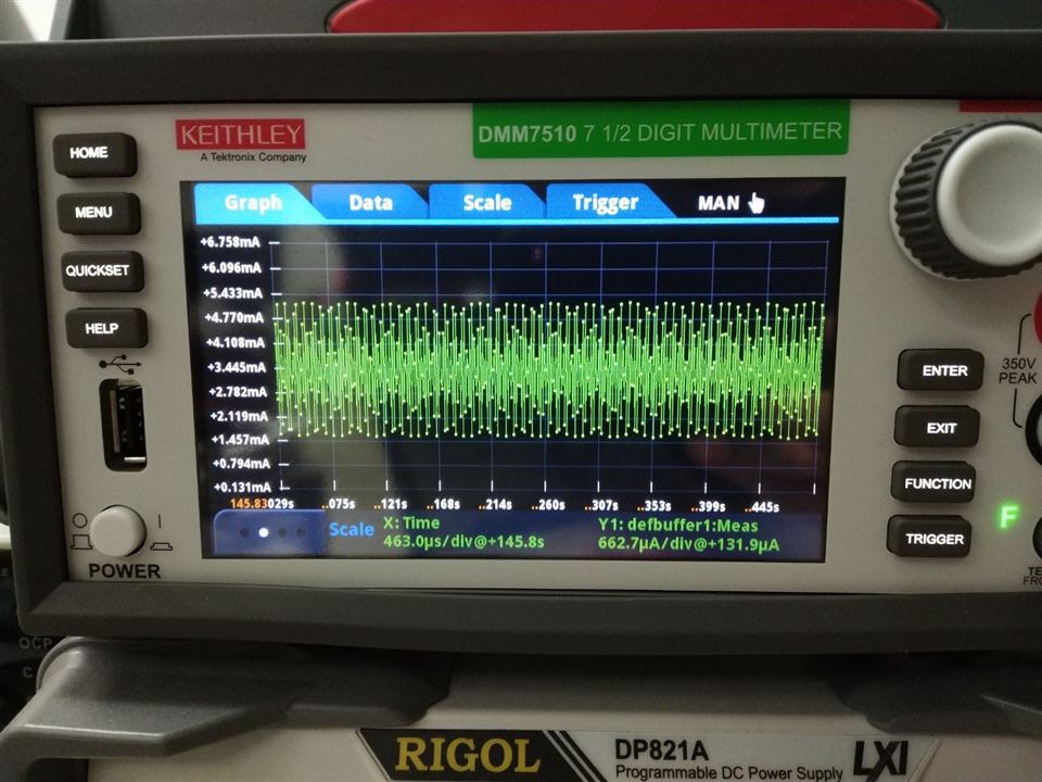

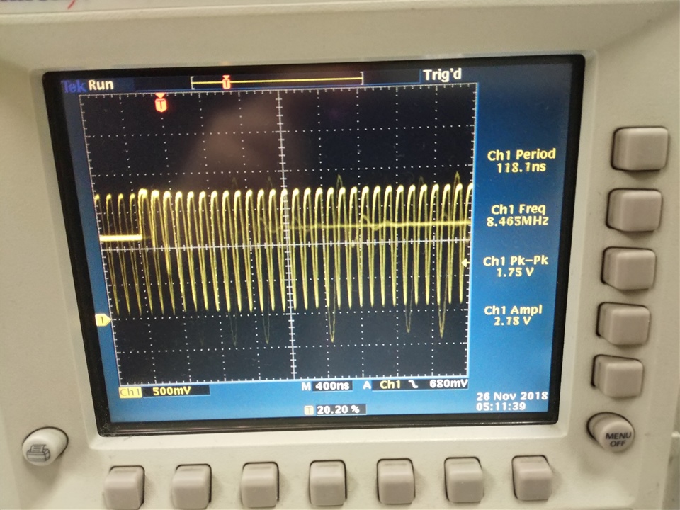

By measuring current consumption of bad unit when MCU hangs, I can see below current consumption behavior.
It looks like multiple sine waves are overlapped by 90 degree shifted but I'm not sure it's meaningful clue for the problem.
