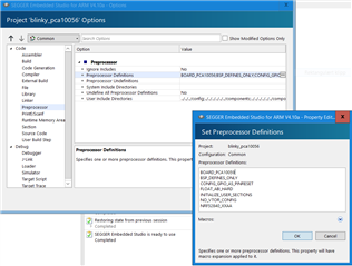

    You already have found the peripheral blinky example, so you could take the central blinky example (examples\ble_central\ble_app_blinky_c) and do the following modification:
    Step 1: Update the Preprocessor Definitions by removing BOARD_PCA10056 and inserting BOARD_PCA10059:
    Step 2: Adjust the linker configuration. Set FLASH_START=0x1000 to place the application right above the MBR. You should also set and FLASH_SIZE=0xDF000 to make sure that there is room for the bootloader at the end of the flash. Set RAM_START=0x20000008, as the first 8 bytes are used by the MBR for interrupt forwarding and adjust the size accordingly by setting RAM_SIZE=0x3FFF8.
    Then just program with the nRF Connect v2.6.0 Programmer Application, as you have already done.
