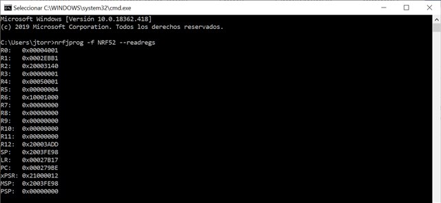

  • Can you run "nrfjprog--readregs" after you've programmed the FW and post the result here?
  • Hi Vidar.
    Here you have the readregs command output snapshot:
    This is the snapshot when the module is programmed with your original ble-uart modified file, which presents exactly the same symptoms than the later modified files we built in our own, further modifying few more parameters. Thanks for your help.
    Juan
  • Hi Juan,
    It looks like your program is entering the app_error_fault_handler() from the UART callback.
    Try to comment out the "APP_ERROR_HANDLER(p_event->data.error_communication);" line for the APP_UART_COMMUNICATION_ERROR event and see if that helps.
