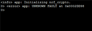

Facing an error while initializing Crypto module along with the BLE Stack
Development Kit - NRF 52
SDK - 15.0.0
Softdevice - S132
Computer Platform - Windows 7 - 64 Bit
I am trying to integrate the ECDSA example with a custom ble application, both of which are working separately, but throw an error when integrating them together.
I am facing an error when I intialize the crypto module along with initializing the BLE stack. I've pinpointed the source of the error, which seems to occur when intializing the hardware RNG.
To reproduce this issue, in the sdk config.h, edit the following parameters.
// <e> NRF_CRYPTO_BACKEND_NRF_HW_RNG_ENABLED - Enable the nRF HW RNG backend.
// <i> The nRF HW backend provide access to RNG peripheral in nRF5x devices.
#ifndef NRF_CRYPTO_BACKEND_NRF_HW_RNG_ENABLED
#define NRF_CRYPTO_BACKEND_NRF_HW_RNG_ENABLED 1
// <q> NRF_CRYPTO_BACKEND_NRF_HW_RNG_MBEDTLS_CTR_DRBG_ENABLED  - Enable mbed TLS CTR-DRBG algorithm.
// <i> Enable mbed TLS CTR-DRBG standardized by NIST (NIST SP 800-90A Rev. 1). The nRF HW RNG is used as an entropy source for seeding.
#ifndef NRF_CRYPTO_BACKEND_NRF_HW_RNG_MBEDTLS_CTR_DRBG_ENABLED
#define NRF_CRYPTO_BACKEND_NRF_HW_RNG_MBEDTLS_CTR_DRBG_ENABLED 1
// <h> nrf_crypto_rng - RNG Configuration
// <q> NRF_CRYPTO_RNG_STATIC_MEMORY_BUFFERS_ENABLED  - Use static memory buffers for context and temporary init buffer.
// <i> Always recommended when using the nRF HW RNG as the context and temporary buffers are small. Consider disabling if using the CC310 RNG in a RAM constrained application. In this case, memory must be provided to nrf_crypto_rng_init, or it can be allocated internally provided that NRF_CRYPTO_ALLOCATOR does not allocate memory on the stack.
#ifndef NRF_CRYPTO_RNG_STATIC_MEMORY_BUFFERS_ENABLED
#define NRF_CRYPTO_RNG_STATIC_MEMORY_BUFFERS_ENABLED 1
// <q> NRF_CRYPTO_RNG_AUTO_INIT_ENABLED  - Initialize the RNG module automatically when nrf_crypto is initialized.
// <i> Automatic initialization is only supported with static or internally allocated context and temporary memory.
#ifndef NRF_CRYPTO_RNG_AUTO_INIT_ENABLED
#define NRF_CRYPTO_RNG_AUTO_INIT_ENABLED 1
// <e> NRFX_RNG_ENABLED - nrfx_rng - RNG peripheral driver
#ifndef NRFX_RNG_ENABLED
#define NRFX_RNG_ENABLED 1
// <e> RNG_ENABLED - nrf_drv_rng - RNG peripheral driver - legacy layer
#ifndef RNG_ENABLED
#define RNG_ENABLED 1
Then, initialize the crypto module and the ble stack together in the main.c file, and run the program. Is there a way to get around this?
  • Hi Vidar,
    First of all thanks for your support.
    Your code sample is working on my end as well.
    Did you make any changes in the application code apart from the configuration changes? I tried setting up the same configuration for my project but the application was throwing the error.
    Anyhow, I can proceed with building my application.
    Thanks again.
    Varun
