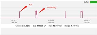

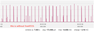

ble_central_and_peripheral Power waste
I use sdk15.0.close log.
config:
#define APP_ADV_INTERVAL                2000
#define SCAN_INTERVAL                   2000
#define SCAN_WINDOW                     0x0050
code:
main()
  clock_init();
    power_management_init();
    ble_stack_init();
    timers_init();
    peer_manager_init();
    gap_params_init();
    gatt_init();
   conn_params_init();
   db_discovery_init();
   hrs_c_init();
    services_init();
  advertising_init();
    // Start execution.
    application_timers_start();
  erase_bonds=true;
  nrf_sdh_freertos_init(adv_scan_start, &erase_bonds);
  // Start FreeRTOS scheduler.
  vTaskStartScheduler();
What else can I do? Can reduce its power consumption.
